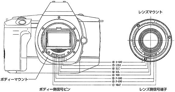

If we measure the voltage between pin 1 (7 o'clock if you are looking at the front of the camera) and the mount, pin 1 shows +5V all the time as long as the SD14 is turned on.
(The red lead of the multimeter going to pin 1 and the black lead going to the camera mount)
The only way to make the voltage on pin 1 disappear is to turn off the camera.
Whereas pin 3 is +5V for a few seconds as the camera is turned on or when the shutter release is half-pressed, but goes back to zero afterwards.
Just wish to see if every SD14 is like that... Thanks for your help in advance!
Hi Conurus,
my 14 shows different behaviour?!
Your 7 o'clock pin 1 ist dead, when the cam is turned on!
If I count clockwise (pin 1 at 5 o'clock) then pin 1 is dead, when the cam is turned on, pin 2 is at 5 Volts, when tipping the release botton and pin three has permanent 5 Volts current?!
P.S. Uwe (Netzuser) is our expert in the cam's electronics. He will surely answer as well!
If we maintain the counter-clockwise counting... Your camera has pin 7 dead (it should - I think that is a ground line), and pin 6 and pin 5 at +5V? (I got that too, these are data lines).
But pin 1 and pin 3 should turn on to +5V when you half press the shutter button, but after a few seconds the voltage disappears, right?

Hi conursus,
my findings : pin1 0 Volt all the time
pin 3 +5 Volts after tipping the release botton halfway (focus) and goes off after a few seconds.
BUT: pin1 has +5 Volts with a lens attached and also goes off after a few seconds.
Maybe this helps:if not known already
don´t get confused with the double P-GND lines, it is for Canon,Sigma only has one line (total 8 with Canon,but only 7 with Sigma)
This might be of interest as well:
Gives some light on converters
Regards
Uwe

Hi conursus,
Regards
Uwe
