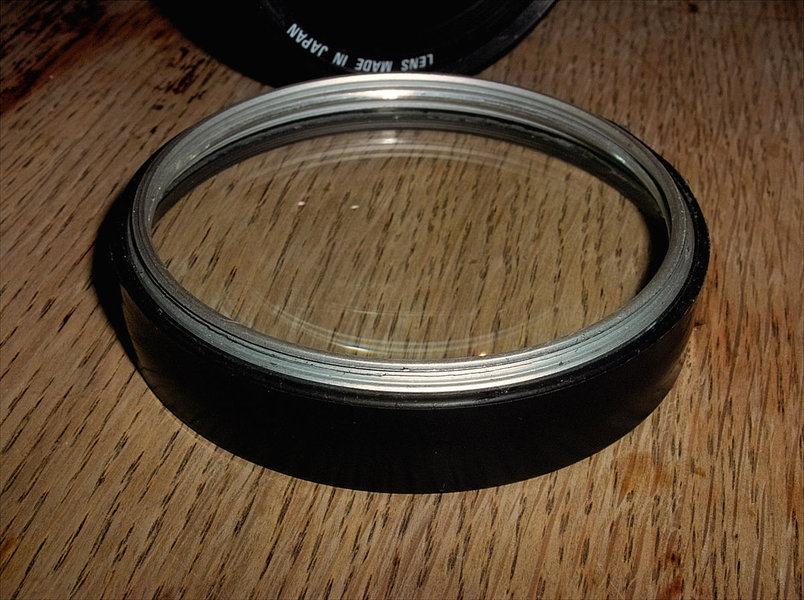

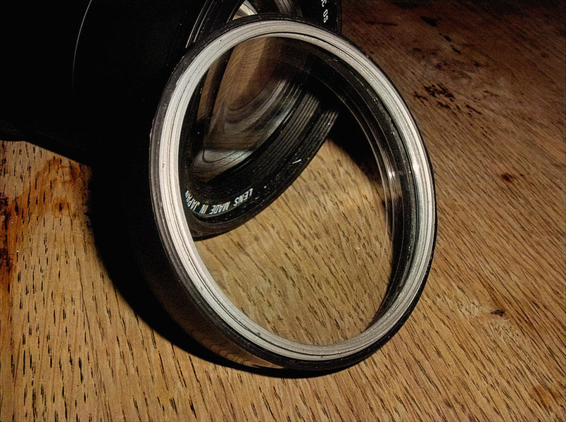

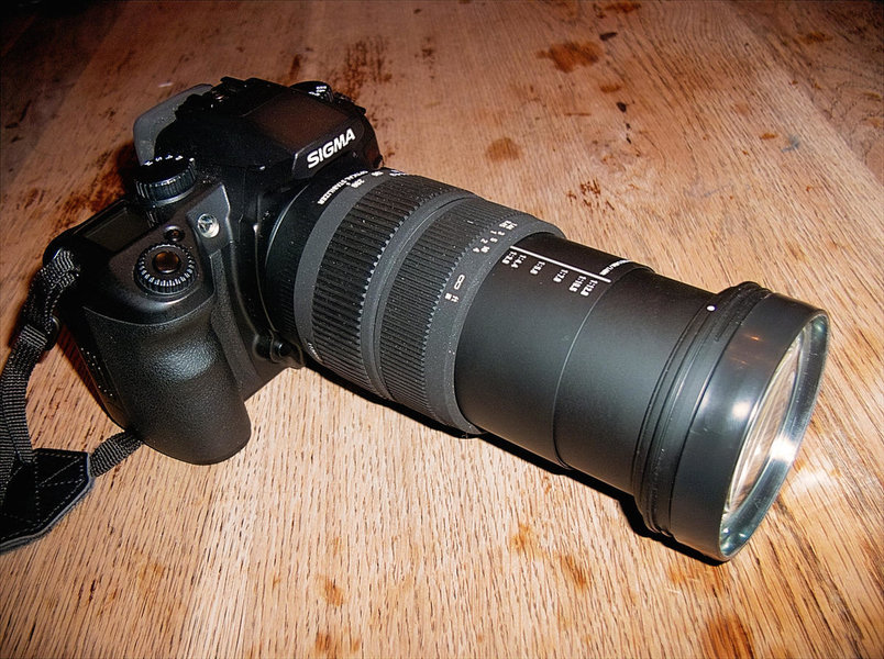

Coincidently, I found a magnifying glass and just held it in front of the 18-200mm OS-lens. It looked at least interesting!
Then I noticed, that the lens exactly had the right diameter to be fitted to the 18-200mm OS-lens.
I then took an old 72mm filter-ring and fitted it to the magnifying lens ... that was it!
View attachment 909 View attachment 910
Unfortunately, I have not got any technical data about my reading-glass construction.

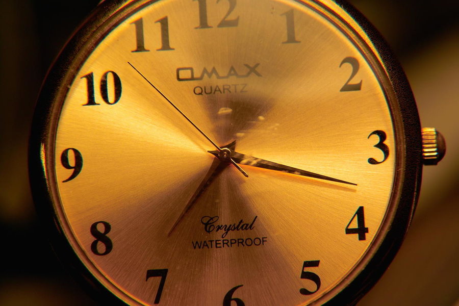

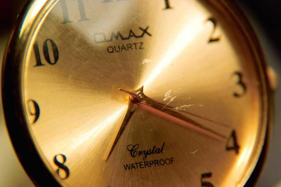

However, image results are surprisingly acceptable .....:z04_photos:
View attachment 912 View attachment 913
Important to know .... thanks to the OS, the right shot could be managed with 1/10s @ 173mm focal length FREEHANDED!
So it should be possible to do macros in very dimly lit situations with neither the necessity of a tripod nor of a flashlight.
Different to the macro-tube test results, you can use all focal lengthes with the reading-lens close-up - construction.
But .... the macro-tube offers a much wider range of possible focus-distances. As mentioned in the other thread, you can focus from 5cm up to 3.5m distance (2 inches up to ca. 10ft)
with the close-up lens you are limited to close distances in front of your lens.
