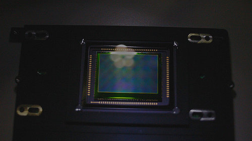

This is what the camera looks like apart...
This is the sensor housing...
This is what the sensor casing looks like...as long as you don't apply pressure you will be fine...

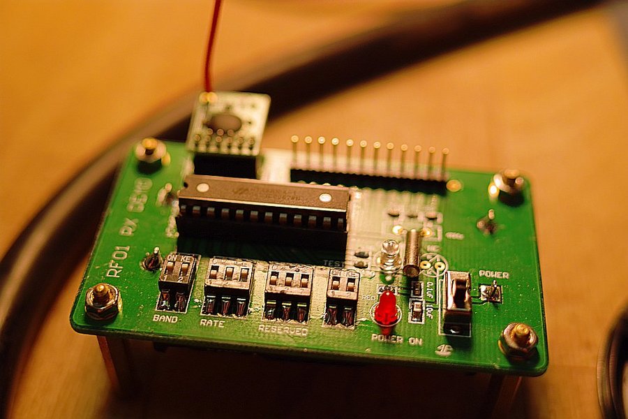

I received my replacement filter on June 12th and here's my first photo after, cautiously, getting it installed:
Yup, a work photo of an electronic demo board. Not the most interesting but it does show all is back to normal. :) And no dust on the imager ;)

iMac,
Tony sent his SD14 off for a customization where the optical window over the imager was replaced by a broad spectrum transmissive optical window. Tony's goal is to maximize the SD14's sensitivity to light that our eyes can't see.
I believe the disassembled SD14 photos were of the camera in a clean room setting undergoing the customization.
