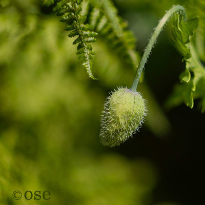

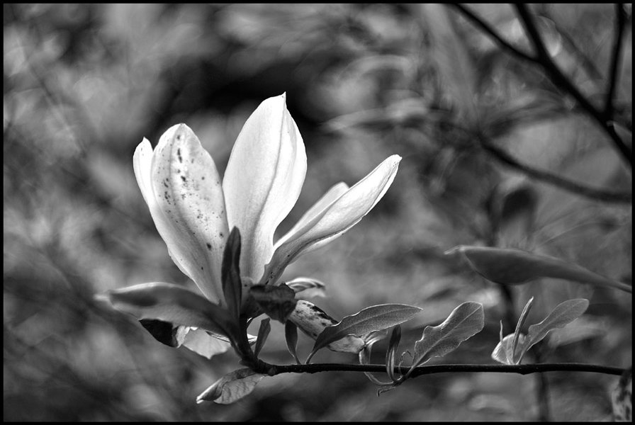

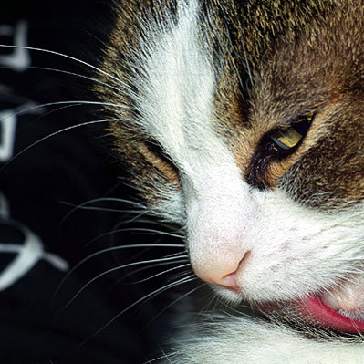

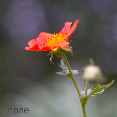

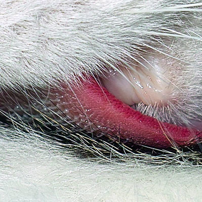

Here are some results made with SD14 and russianmade Helios44 58mm Lense:
1,2 and 3 are f2, ___ 4 and 5 f11.
I adore old glass on new cameras..

Your images surprise me regarding the excellent bokeh and almost no Chromatic Abberations...which you usually get from older anlaog lenses a lot.
The sharpness is fantastic though.
Well Done !
