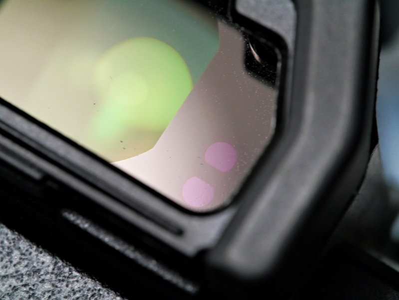

Here you can see the emitter and receiver on an OM-5, on the EM10 it should be very similar.

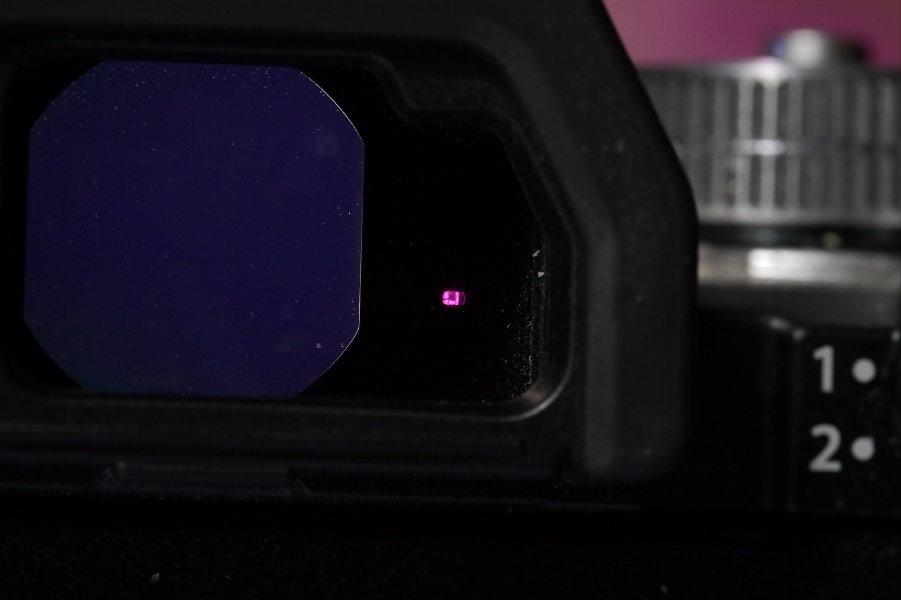

Thanks to the less-than-perfect IR filter in my GX1 and overlaying two exposures, we can see that the transmitter is the top element.
Fun fact: hitting the EVF with an infrared remote control will briefly activate it.
