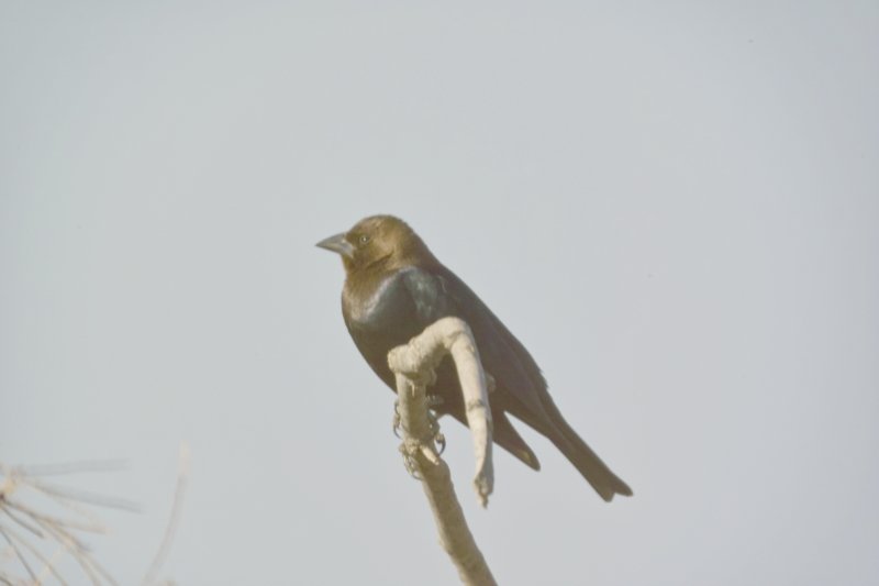

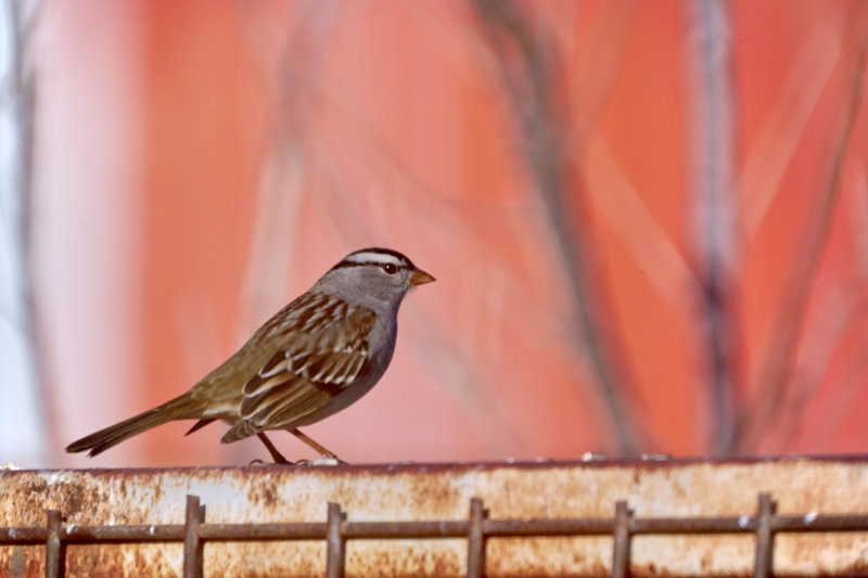

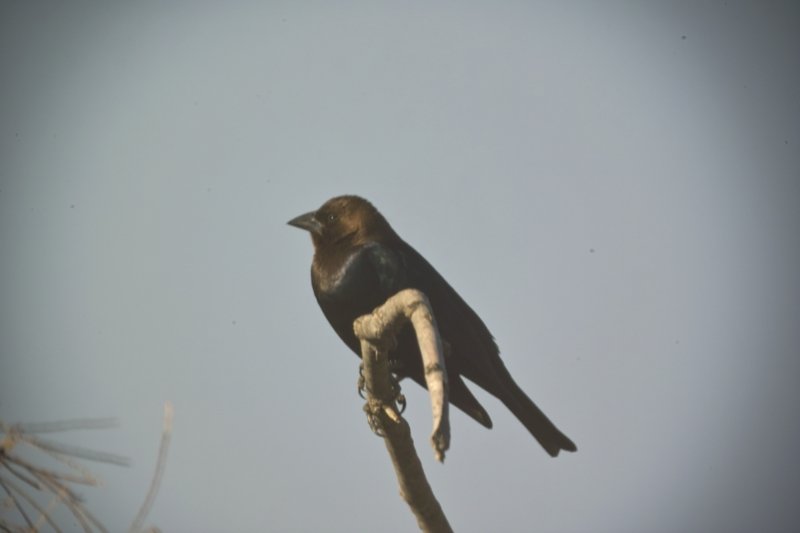

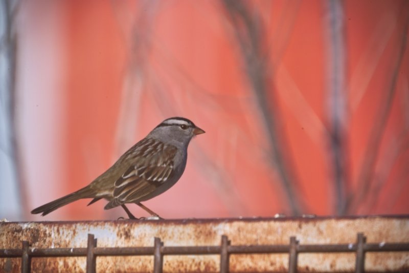

Having finally received my new Orion Apex 90mm Ø Maksutov Cassegrain with a focal length of 1250mm, the SD14 making this equivalent to 2125mm, here are a couple of my early shots:
I was roughly 50 feet (15 meters) from the birds.
Both were processed in DeepSkyStacker to compensate for vignetting from a separate flat frame exposure. Neither photo was cropped and the complete SD14 image frame is shown here.
Both, obviously, were shot from a tripod.

I would not say that the images are flat, I agree the contrast is not peaked, but as I said in the original post, these are some of my first photos through the scope and I am also working through the learning curve with DeepSkyStacker to compensate for scope vignetting with a flat frame. The post stacking adjustment tools in DeepSkyStacker are not the most intuitive.
To get a better sense of how the 90mm Ø Maksutov Cassegrain performs with a SD14, here are JPGs processed with SPP from the original X3F's:
See plenty of contrast and nicely clear.
The issue with DeepSkyStacker is that it is software designed to process astronomical photographs, not wild birds. I'm using it in a manor which is undocumented and I will need to play with it to preserve the SD14 clarity while compensating for the scope limitations.

As you can see, the SD14 does capture a good image, but it still needs work.
The output from SPP yielded a 4573 x 3048 pixel image and I wanted to preserve the resolution while also not performing any cropping.
I found problems with the perched Cowbird on the branch due to camera shake from not shooting in mirror up mode. The Sparrow on the fence was fine and I decided to go with it.
DeepSkyStacker outputted a Autosave.tif file with 96 bits per pixel and even photoshop choked on it, even if only 32M in size.
I had to find a HDR image processor and decided to try FDRTools Basic. FDRTools was able to read DeepSkyStacker's Autosave.tif and I was able to reduce this down to a 16 bit per pixel PNG file, which turned out to be about 41M.
This was within Photoshops comfort zone and I was able to adjust the levels for this resulting image:
I feel that this turned out to be a nice full frame image with the Orion Maksutov Cassegrain - SD14 combination.

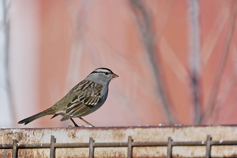

Hi Steaphany,
you obviously did vignetting very successfully! :)
I think, you can optimize contrast a bit.
Compare:
Original ......................................................................................... More Contrast
View attachment 1185 View attachment 1186
I did not change the highlights ... just darkened the shadows slightly.
I hope, you do not mind me to work on your shot? :) If so please feel free to complain .... I am going to delete it then.
See you with nice shots
Thanks for your work, that is a good improvement.
We're both thinking along the same line with different methods.
I also do not mind you experimenting. It helps everyone get an idea of what is possible when photographing through the Orion Telescope.

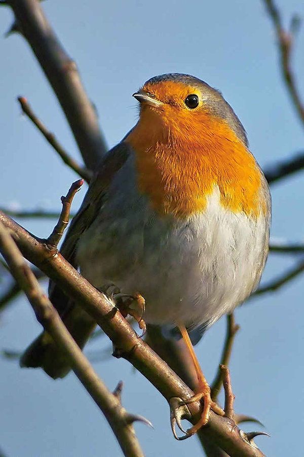

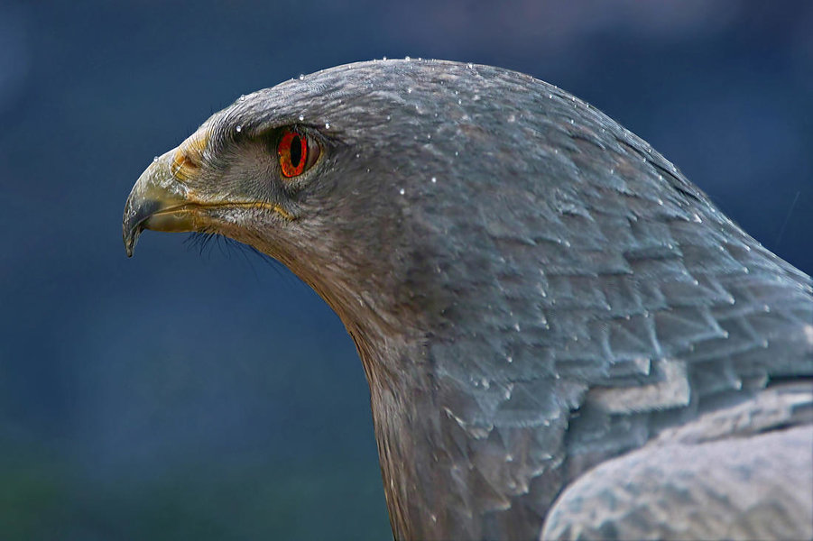

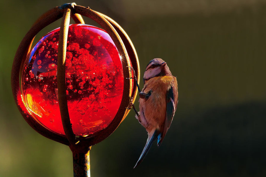

I have quite a number of telephoto-lenses available. It is extremely difficult to find affordable, fast enough, high quality lenses. I am well equipped up to 500mm. I also have a SIGMA 80-400mm EX OS + a 2X-Extender.
Image quality is quite well with the extender ... but it makes the lens comparatively slow.
View attachment 1187 View attachment 1188
View attachment 1189 View attachment 1190
If this IQ could be managed with an affordable telescope it would be quite an alternative.

For the Cowbird on the branch, No, I did not use Mirror Lock Up Mode. I saw that the reflection of the Sun in the Bird's eye was a triangular jiggle.
For the shot of the Sparrow on the fence, Yes, that used mirror lock up.
If you look close at the Sparrow's eye, you can see the Sun's reflection as a nice small point and the brown of the iris clearly visible and distinguishable from the black round pupil.
