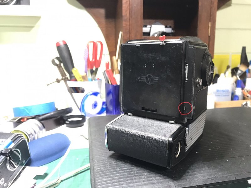

Sansan,
Hi, I’ve just picked one up as a spare (I have another which works fine) but I’m keen to try and fix it up. It dry shoots with a back on, but only in ‘ T’ mode - after each shot, I have to go back to ‘O’, the camera resets for the next shot, and back to ‘T’ to shoot again. Is that a ‘standard’ problem? I’m assuming that if the motor is working, the fix is a gear/ contact...? If I take tweezers to the little tab (film back off now) that pops out to change the film back white/ orange signal? (circled in red in the attached photo), I can dry shoot in ‘O’ mode no problems. Any ideas? Another question- do you have a repair manual .pdf? Cheers from Toowoomba, country Australia, Mark.
