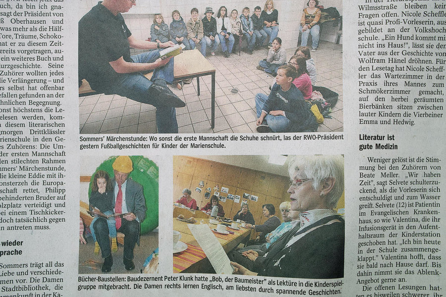

Well, since the AML-1 is quite an expensive close-up-lens, the question comes up, whether it could do to replace it by a cheap standard macro lens. I tried so! :)
DP1 + AML-1 + open aperture ..... DP1+ 4dpt-lens + open aperture
View attachment 1644 View attachment 1645
The answer is a clear NO, you cannot replace it by any cheap stuff. Obviously the AML-1 is a special design for DP1 use in particular. AML-1 image quality is outstanding!
By the way ... results widely improve as soon as slowing down the DP1's aperture down to 8.0 with the cheap lens.
But how to get really close?! :)
DP1+ AML1 + 4dpt-lens + open aperture
Well, I think this is acceptable image quality, is it not?!
To have the edges a 100% sharp, you have to slow down aperture a bit.
DP1+ AML1 + 4dpt F:9 .....................DP1+ AML1 + 4dpt F:11
View attachment 1648 View attachment 1647
For comparism:
DP1 + standard 8dpt macro-lens.
Conclusions:
I think, it is nice to conquer the macro range with the DP1! It seems as if this was not possible without the AML-1.
If you would like to go closer than the AML-1 allows, you can do that nicely with additional close up lenses in front of the AML-1.

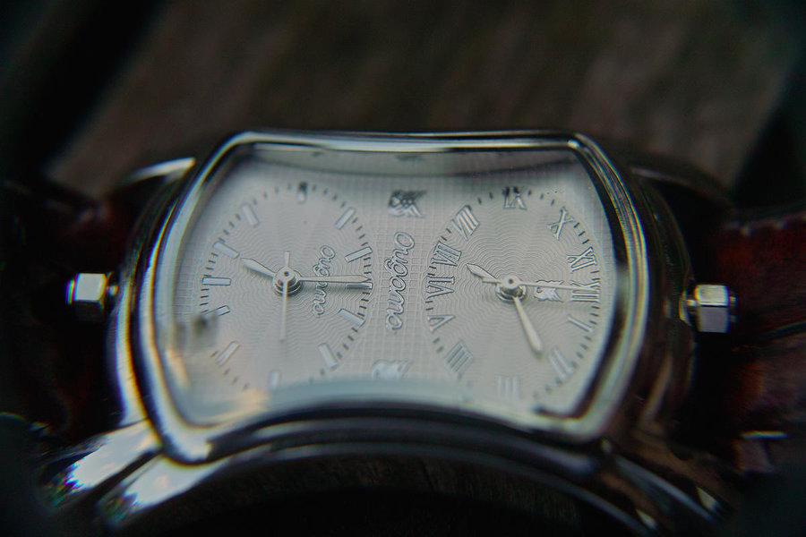

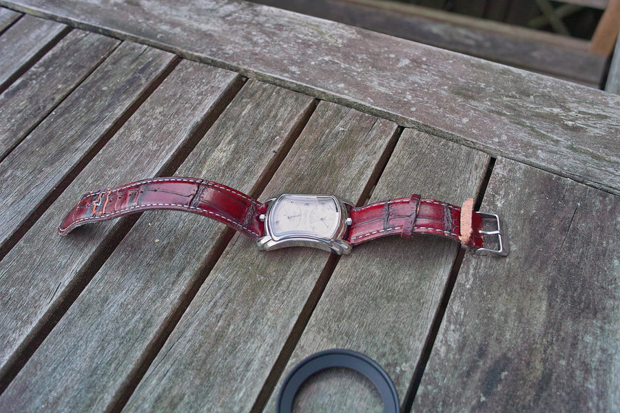

Here are a few from my DP-1
I am using a generic 2x Macro lens...on my DP1...but it still gives you outstanding results...
Thanks for looking...
Tony C.
High Tony,
that looks fine indeed!
There are not many macro scenes indeed that require sharpness up to the very periphery of your picture.

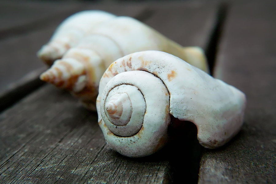

Klaus...great combo....I love the shells...
Tony C.

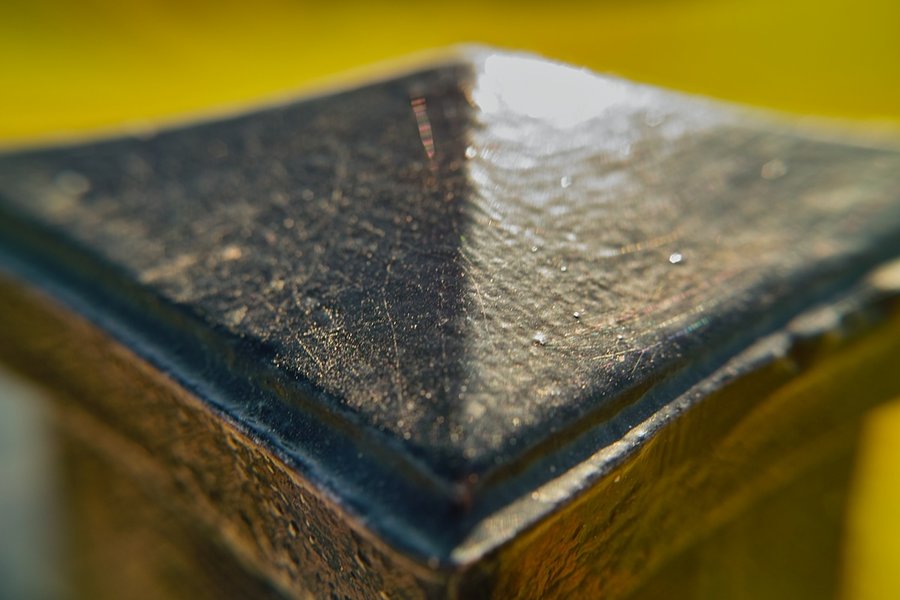

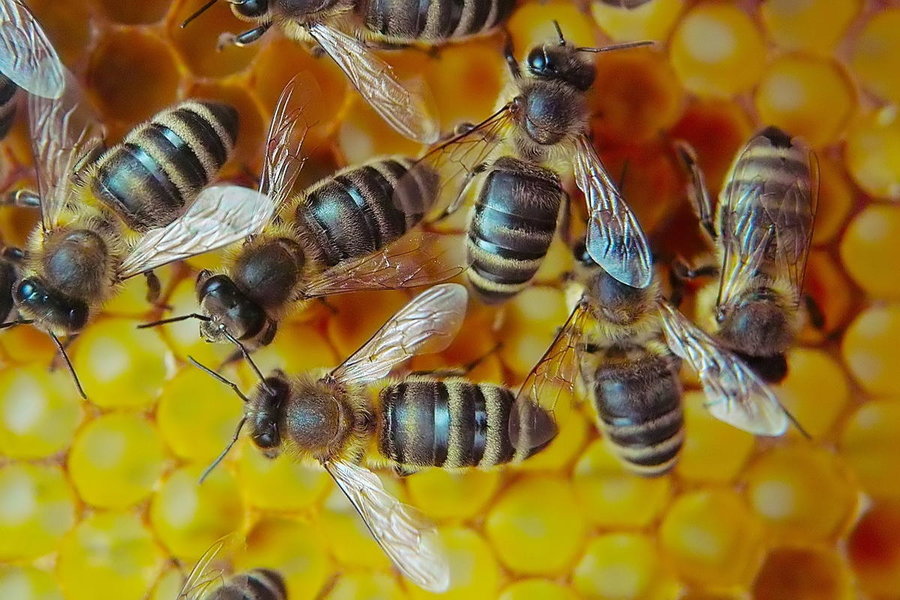

Hi All,
SIGMA DP1+AML-1 + 8dpt close focus lens + ISO800!! + 1/20s freehanded
ENJOY!
Klaus....Great color on the bee's with the background...honey-comb....

Hi Tony, they're definitely fine pics, but it's not a good choice of subject to show the quality of the lens from the perspective of sharpness across the frame. Klaus' choice of shooting a newspaper may be boring, but it showed quite well the IQ differences between these lenses on sharpness. Because the borders and edges of your images are out of focus, it's just not possible to tell very much about lens sharpness from these shots. [on revisiting your pics, it looks to me that the top right corner of the 2nd photo is showing signs of smudging rather than simple defocusing - it looks quite ugly once one notices it.] Central sharpness and bokeh with your lenses are good, but that's only half the story. If you have time, it would be really interesting to see you post some shots of a subject in a flat plane to compare with the lenses Klaus was using. Thanks in advance.
