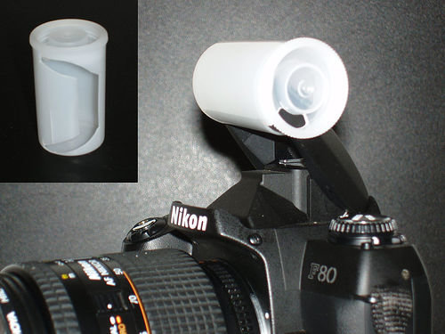

I would try the paper first...here are a few cool little DIY defuser I found a few years ago....before I picked-up flashes....(NONE of these are my designs...I just found them and used them...)
And one that I came-up with out of necessity...one time... I took a finger rubber...the ones used by nurses...and put a piece of silk inside...and stretched it over my flash...actually worked great....
I actually have several old film holders that I have turned into defuser and carry with me now...

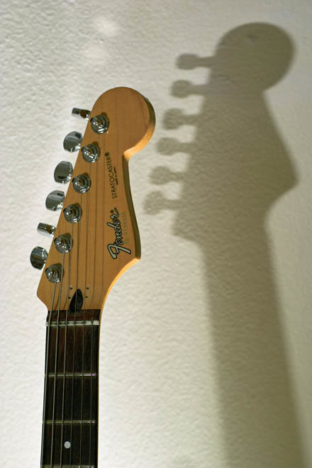

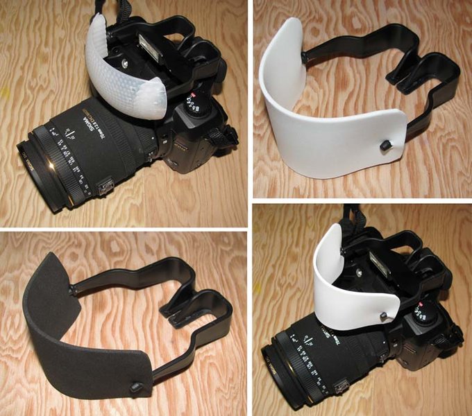

It helps to know that there is no way to control the output of the on-camera flash. I already had the "Puffer" flash diffuser, but found that still too much light was coming through for some shots. The Puffer comes with an armature that makes it pretty easy to mount something else in front of the flash, though. So, I cut a diffuser from a simple sheet of white craft foam (2mm thick), and another out of black to see what would happen.
Here are some sample shots. Exposure and SPP treatment are identical on all shots. Only the diffusion of the on-camera flash has been modified. I shot in portrait orientation to exaggerate the shadow cast by the on-camera flash
There are two off-camera flashes in slave mode. The first hits the guitar straight on and casts the shadow with the tuning pegs. The second is on the floor just behind the guitar pointing up, emphasizing the texture of the background and creating the reflected highlights on the wall.
In the first shot, the on-camera flash is unmodified:

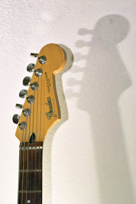

In the second, I've attached the Puffer diffuser. It softens the edges of the shadow cast from the on-camera flash, but it's still intrusive:
In the third, I've removed the Puffer, and put my white foam diffuser in front of the on-camera flash:
In the last one, I've put the black foam in front of the on-camera flash. There is still plenty of light to trigger the slaves, but only the slightest amount of light is bouncing from the on-camera flash in the small room I'm shooting in. With the black foam on, I notice that the flash makes a louder pop when it goes off. I'm not sure what could be causing that:
