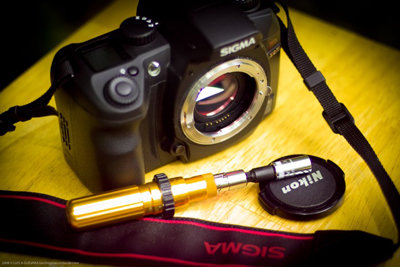

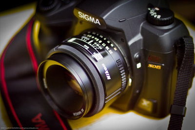

I'm really looking forward to playing with this camera soon. But first, I need to try to switch out the camera mount. My SD14 has the Nikon mount. I'm hoping the two cameras are essentially the same in this regard, and I can just swap the two mounts (then sell my SD14 with its original Sigma mount installed).

Cool I am interested to find out if you can switch the mounts...keep us informed....
Yes! The factory Sigma lens mount on the SD15 was successfully switched with a Nikon mount (as it has been done on the SD14).
Luis Guevarra (he's great to deal with) at: http://www.sigmacumlaude.com used my SD15 as an experiment and model for future SD15 mods. He produces two mount models - the better version has a few more screws for sturdier operation with heavy lenses. There were some differences in the new mount but it was not to hard to accommodate to them.
The new camera has some very welcomed advances of interest for converted cameras. The Internal Focus Confirmation works very well after conversion. It's very sensitive, even works in low light and well stopped down, and the Beep is not a faint one as in the SD14.
Exposure metering works well in Aperture Priority by setting the Aperture Dial to f1.0 and, when shooting Light or Bright Objects, dialing in an E.V. Compensation of -1 Stop, sometimes more. This seems to be a problem to all SD15, not only to converted ones, as I been seeing in images shown in forums and reports of users burning the Highlights.
The Memory Buffer is larger and you can shoot longer sequences without choking it. Menus are better with more useful options. The large LCD screen is a welcomed change.
I did not see color problems worth mentioning. Auto White Balance seems to work well , but ISO beyond 400 are still not really usable, ISO 800 might be usable for some type of images . High ISO might be a good things for the camera's new Black and White option, as the Grain can add character to Dramatic Images.
