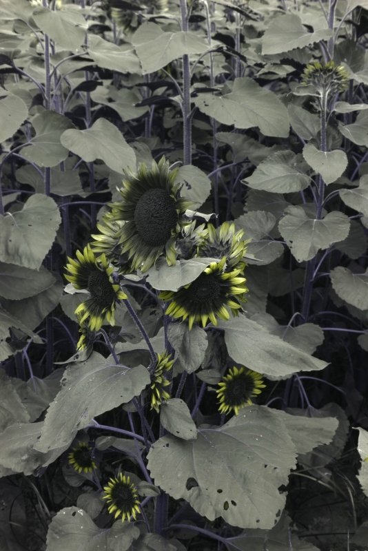

Sunflower field in UV light
barondla
Mar 30, 2023
127
Kolari modified Pentax K-1 full spectrum DSLR with Nikon EL-Nikkor 80mm metal body enlarging lens and focusing helicoid. Hoya U360/Schott S86712 filter stack, each 2mm thick, to eliminate all visible and infrared light. F11 and 5 second exposure at ISO 800.
UV light doesn't have color. These false colors are caused by the Bayer filters over the sensor. They colors can add to the image and even have some scientific uses.
Thanks for looking,
barondla
Thanks for looking,
barondlaView attachment 24609
Belongs in a sv fi movie I think. Weird colorations!
