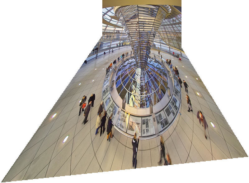

Next, I stiched both shots using ADOBE's Photomerge function (part of Photoshop CS3)
Finally, I corrected perspective and distortion and did a sensible crop ...
well, this way you can do wide-angles, which cannot be done optically. Another point is a considerable increase in resolution .... simply because you combine the pixels of more than one frame.
