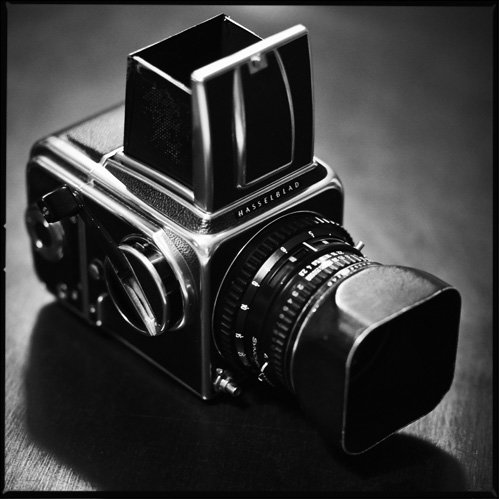

and as an introduction: i just got myself a '72 Hasselblad 500C with interchangeable focussingsccreen!

Thanks Maarten. Uploads help the forum to give complete posts instead of becoming Swiss cheese with lots of holes in it.
Nice camera, looks like a well used sample with lots of mileage left.
Paul
thanks,
the shade looks like it's been dragged and thrown around a bit
but the camera itself looks in pretty good condition.
