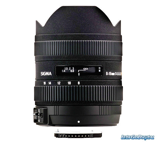

Robert...Sigma makes a 8-16mm non-fisheye lens...there is a little vinyetting at 8mm..but it's really not that bad...I played with one at a store...and it's now on my short list of lenses I want...the 15-30 does the same thing on film at the outer-edges...
Hope this helps out...Tony C. :z04_cowboy:
