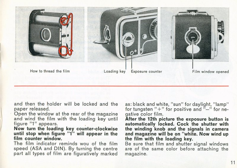

From what I read I suppose you have the second model film back.
Just to be sure I also uploaded the early model as used with 1600F cameras.
Early film backs
View attachment 1465 View attachment 1466
Later film backs
Early film backs have the window of the exposure counter further away from the red/white indicator.
Most of the loading was done correctly.
Please note after you have slipped the tip of the film in the take up spool do not advance the film but lock the insert in the housing.
Open the little door at the rear of the film back look through the peep hole while you slowly advance the film with the RH knob on the film back.
As soon as "1" appears stop the forwarding of the film.
Close the little door, turn the RH knob anti clockwise.
You are ready to take your first picture. That is all there is to it.
If you have a different film back try to upload a picture of it.

Oh wow that is fantastic help!
Looking at the pictures, and the exposure counter specifically, it looks like I have the example in the first of the images you have uploaded.
No wonder I did it wrong - I was looking at the wrong window!
I have a 1 through the rear window, and a 1 in the side window. It seems as though I'm ready to go!
I will let you know how it turns out :)
Congratulations again.
You have an early, model 1, film back suitable for use with a 1600F camera.
With suitable I mean correct for the period of production.
These film backs can be used with all cameras up till 1957.
The 500 C camera introduced in 1957 demands a modified back that was first sold in 1955.
Film backs with peep hole were introduced sixty years ago and were discontinued, the second model, in 1968.
Although many of these early backs with peephole were last supplied at the end of the sixties they were
still being used in the seventies and eighties by professional users.
