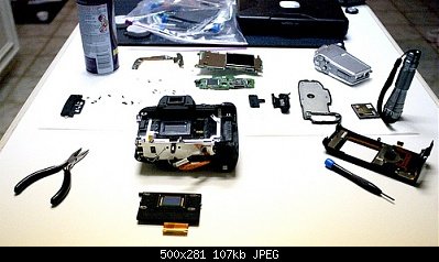

Pedro,
The Mod is possible...having pulled apart the back panel...yes you can do it...but you would have to find someone that could mold you a part...and someone that could design the paper thin connections to make it work....
I don't think it would be feasible...monetarily....it would probably cost you the same amount of money or more than a new SD14.....
I would maybe see if someone could create an attachment prism type devise using mirrors and glass to achieve the same thing.....
In the picture below you can see the lcd board and connections at the top of the picture the LCD is incased in a metal shell...
the plastic back can be adapted fairly easily to do this...the problem you have if you did this is creating a sealed compartment behind the LCD so that dust and debre did not get inside the unit......
I hope this helps....(this would be a cool mod...!!)
Good Luck....
Tony C.
