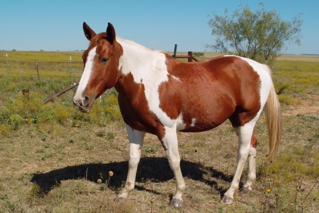

Original SD14 X3F image:

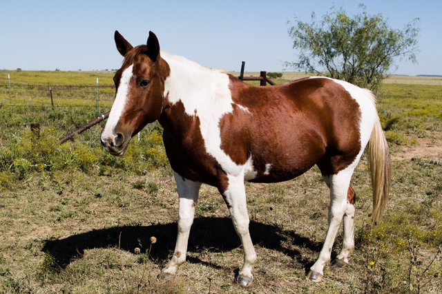

Silver Efex Pro Bleach Bypass Effect:
It does look more "filmy". And the highlights are brighter without that haziness you get from boosting the exposure or bringing up the shadows in SPP. And the blue sky isn't as electric. Which is a good thing. I hated the way my Fujifilm A450 made the blue skies too blue.
