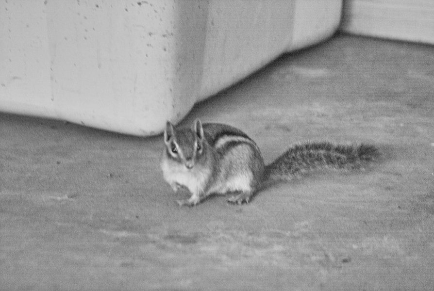

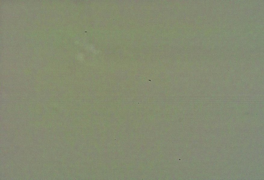

Hi all,
I've been noticing that I've been getting banding on some images from time to time.
The major part of it is across the lower half of the frame when holding the camera normally.
I first noticed it when I used my Sigma EF 500 DG Flash wirelessly. There was very obvious banding on the lower half. In some other images I notice it but it's very faint.
In the test image I used to look for dust spots you can see it across the whole image.
And in the chipmunk image the camera was set at 1600Iso and I used the built in flash.
I sent an email to Sigma USA but they didn't say much, they didn't think it was an issue with using the wireless flash. And said I could send it in if I wanted.
Anyone else have these issues? I've got a Square Trade Warranty on the camera and I was wondering if I should send it in or not? Recently it only seems to show up in the high ISO shots and not always.
Thanks for any input!

Thanks Tony,
I knew about the higher ISO issues that the SD14 has. But I've noticed the banding in shots where I used the flash in lower ISO settings. And the banding on 1600 seems to be a lot worse than some of the examples I've seen.
I hardly ever shoot above 400, unless I'm going to take the color out.

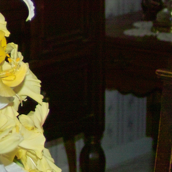

I have seen this once with my SD14. I have just purchased the camera and taken only a couple dozen pictures so far. Here is the EXIF from the original picture.
Camera Model: SIGMA SD14
Image Date: 2009:04:18 09:37:06
Flash Used: Yes
Focal Length: 18.0mm (35mm equivalent: 30mm)
Exposure Time: 0.017 s (1/60)
Aperture: f/3.5
ISO equiv: 100
Exposure Bias: -0.70
White Balance: Auto
Metering Mode: Center Weight
Exposure: program (Auto)
Exposure Mode: Auto Bracketing
Sigma 18-50mm f3.5-5.6 DC Lens
Here is a crop:
Thanks notalent!
I was starting to think it was something I was doing.
When I noticed it in the lower ISO settings for me I was using a 500 dg flash remotely. So I did trigger the in camera flash, that might be something we did in common. I get it mostly on the high ISO though but it doesn't happen very often at all, so I'm thinking it might be a battery issue.
My lines go horizontally when I hold the camera in landscape, and I notice that it's more visible in the lower half of the image (if you divide the image directly in half it becomes more prominent right at the middle).
