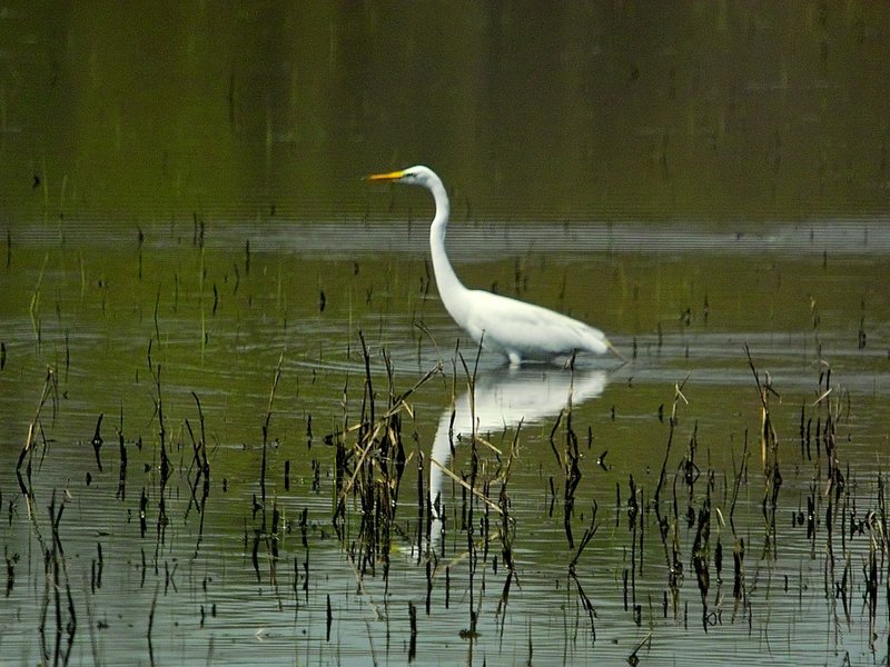

Hi AKV,
This week-end my counter passed 30,000. but the important part is that I saw the first banding problem. I usually only shoot in Raw. Somtimes lo or med depending on the sustained burst rate that I want to achieve. This instance was shooting HI-Raw spot metering, and was birding, so the shutter was continue pressing. I am probably not saying this correctly. I am trying to say that I was pressing the shutter while the images where still processing through the buffer.
Usually I replace the battery as soon as the blink starts. I have noticed that it can remain steady, but when you press half-way, the demand is enough that the battery icon may blink. On this day, I was shooting a lot in succession with the DB-DP400 1500mAh (which historically has not performed well for me, the weakest of 4, and this one is a warranty replacement for the first). When finished pressing the shutter button and let the buffer clear, the icon never stopped blinking.
Impression: the battery was depleted much farther than I previously use it. I often shoot many shots in succession when birding, but always change the batt's, as soon as they blink, even if they start blinking when under continuous processing.
Looking back at the time of exposure, I am estimating that the banding exposure was taken during this low charge period, because I can roughly remember the time of day and subject I was shooting when the battery needed changed. I also shoot 800 pics over the week-end and looked at them all for banding after I found the first. Only one existed.

I see the banding at at rhe reflection at the neck of the bird. The ripples in the water are a circular pattern radiating from bird. These in the reflection are clearly horizontal. When first looking at it, it can almost pass for ripples.

The banding example:

Thanks Robert,
I've noticed that my blinking battery icon goes on and off sometimes. It'll blink, I'll take an image, then it'll stop blinking and I can continue shooting.
I use the original BP-21 battery that came with the camera as well as a CTA replacement I got from Cameta Camera.
I've also noticed in my banding issues that I get a "fine banding" as well as a "rough banding". Sometimes both in an image, like yours has. The "fine banding" is the tight clear horizontal (in landscape) lines across the image. The "rough banding" is also evident in your image up near the top. It's not as clearly defined or as tightly packed for lack of a better term.
I've only assumed that it's a battery issue (from the limited input I've gathered) because I've seen other technology perform the same way when it's low on energy. Tvs, monitors, hand held screens. And I think we can put the image processing as a lesser possibility of it being the cause since we have limited examples of banding in both HI RAW and MED RAW. Though no examples in Low RAW or Jpeg as yet.
And I think the connection to using the flash can be ruled out too, from your image, although it could be connected to the low power issue in that it is a drain on the battery at the time of shooting.

Hello Robert,
I could be wrong of course, but the problem with those calculators might have been in the analog elements in the LED display, not properly displaying the otherwise correct number.
But your low battery situation does seem rather coincident with your banding example.
