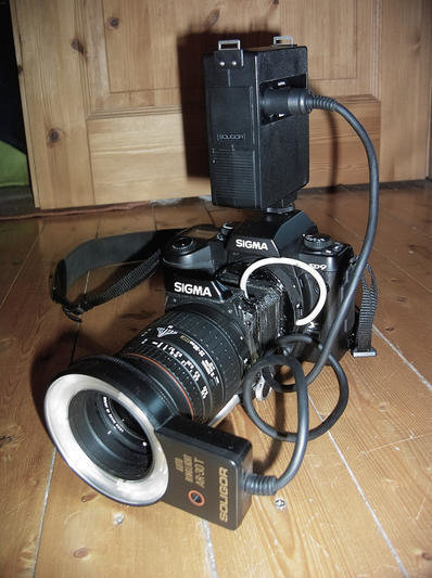

THE SIGMA BELLOWS:
This is mine .... SD9 in combination with the SIGMA 28-80mm HF MACRO lens and an old SOLIGOR ring-flash.

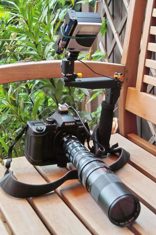

Hi All,
today I again managed to take some flies. The only thing, I did differently was that I did not use my ring-flash but an ordinary one, which I fitted to a rail ... I show it below:
So, the flash light comes from overhead, which certainly leads to shadows.
On the other hand a larger area is illuminated (so you do not have the problem with black-backgrounds) and, as I think, you have a very natural light situation, next to an available light situation indeed.
Have a look:
All shots again are SD9 / SIGMA 28-80mm HF MACRO / SIGMA SD Bellows / Metz 34-CS-2 (with wide angle screen on).
The flash was set to full power so I could stop down the lens to an apperture of 16 for at least "some" depth of field
