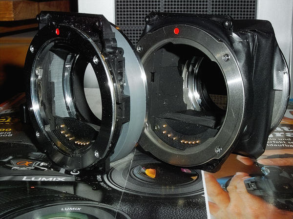

Additional 45mm Macro Tube
Hi All,
nobody can stop me! ;)
I built an aditional 45mm macro-tube. Sure, that it can be combined with the above mentioned 20mm-tube from Uwe's production.
The making was a lot of work (took me about 4hs!) but it is no magic to do.
45mm you simply reach using the complete light-case of an old SIGMA SA300.
The only problem then is, to have both bajonettes arranged half way centric, since the light-case is designed asymmetrically.
To have it impermeable to light, I simply used some insulating tape.
The elecric wiring is the same as with our bellows ... just compare HERE.
Let's have a look! :)

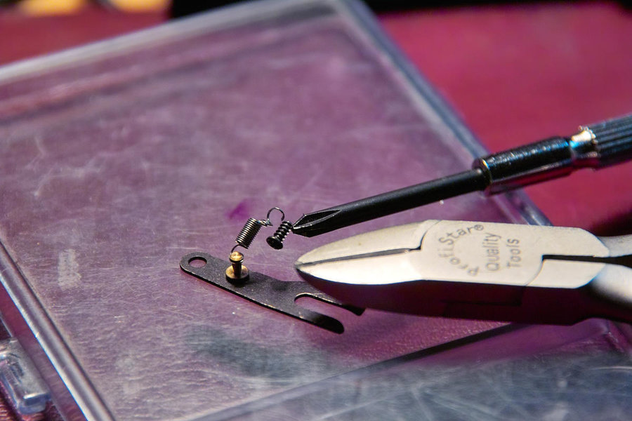

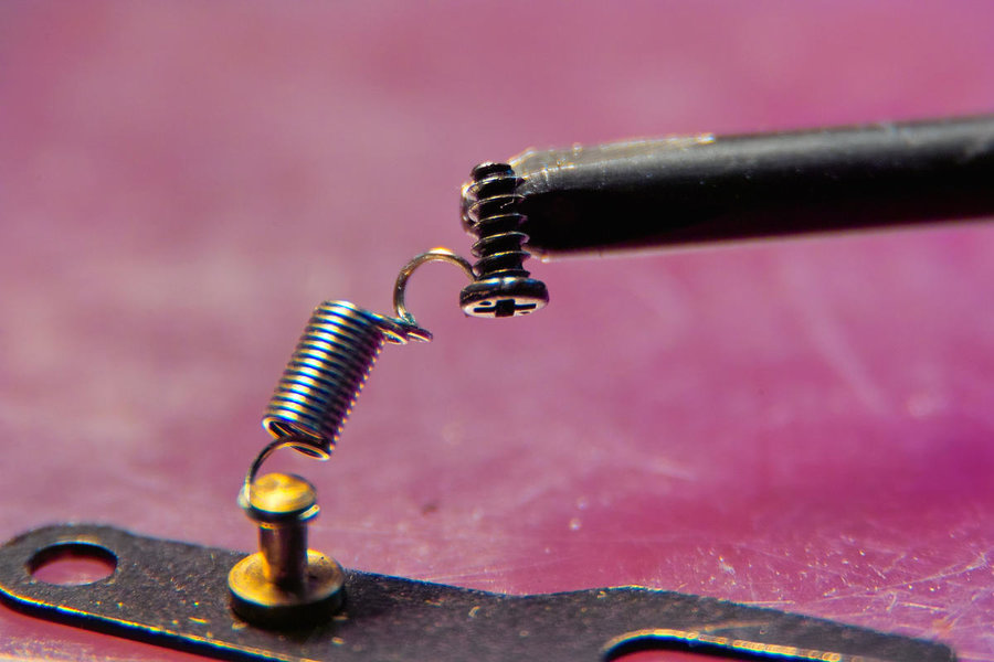

SIGMA 18-200mm OS
All that goes without macro-aid: ......................... / ...........................Both tubes fitted
View attachment 923 View attachment 924
Findings:
1) The OS works beautifully within macro range! The macro is done freehanded (ellbows supported on the table) at 1/4s!! shutter-speed 173mm focal length and ISO 400. I used a dim 40W desk lamp on purpose, since we are talking about AL-OS-macros!
2) Image quality is considerably well with the lens on open aperture!
3) The depth of field runs towards zero (as you can see!)
4) The loss of light is something around one aperture value (you can live with that!)
5) As I indicated above ... the bigger macro-tubes can only be used with the longer focal lengthes of the lens although magnification can be increased visibly to an estimated 1:1 ratio ... therefore, Uwe's 20mm tube is the best match with the 18-200mm DC OS lens.

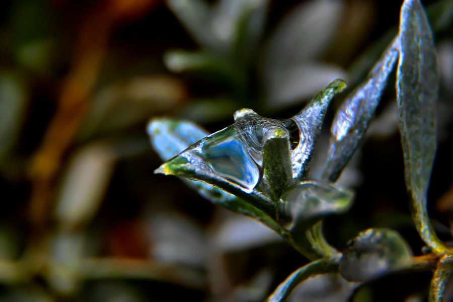

Well, I do not like test-shots all that much ... therefore I did all in my power to have a considerable macro at hands for illustrating the above mentioned devices. This was a difficult thing to do, because of very little light available in the garden.
Exposure: ISO400 / .....1/30s.... / F:5.6 / 115mm
At least I managed this one this afternoon .... a very little moss-plant carrying a water-drop.
