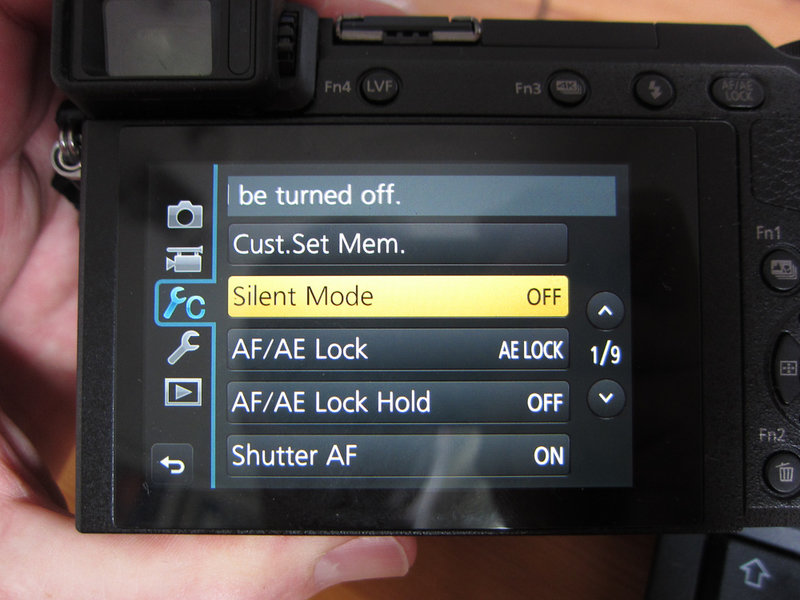

1. Sound

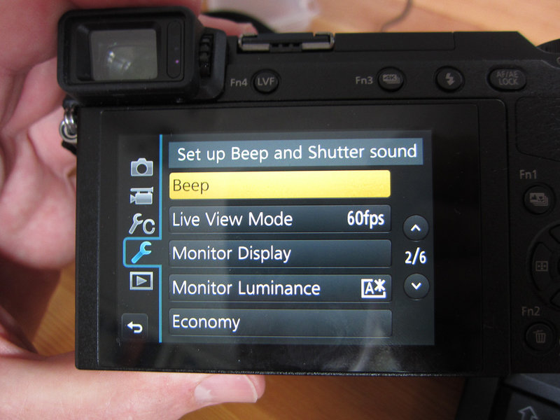

The first setting I always change with my cameras is the sound. I do not like sound. I want to be stealthy while I take pictures. And here is the problem. With the GX80/GX85, there are 2 different possibilities to turn off the sound. even worse. both options are in two different setting-groups. So if you do not know that there are two different ones, you make mistakes :(
A. Go to "Custom settings". There is the so called "silent mode", which you always find first. Unfortunately. Because if you turn on this silent mode to "on", you will not hear a sound anymore, but at the same time, you will not have anymore the mechanical shutter available. And this is for my kind of photography very bad. I absolutely want to use mechanical shutter as much as I can. So do not use this setting to turn off sound!
B. Use the other option instead. Go to "set up" and there to the setting called "Beep". Within that option there are 3 different settings available. I always turn off the first two, the third I leave it to "1" to have an alert, if the ES is used.

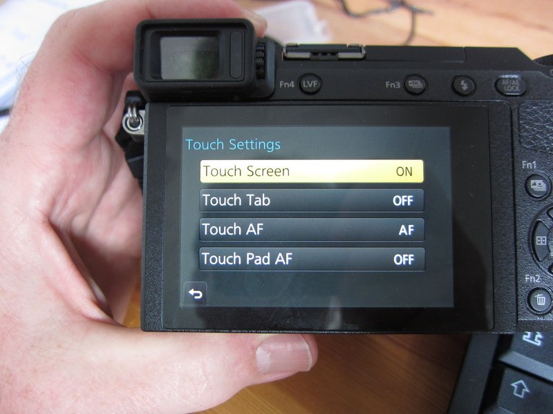

2. Touch Screen
There is another setting which drives me regularly crazy with cameras. The touch screen. I mean I love touch screens. They make many changes so easy and quick. But this is at the same time also the disadvantage. Because sometimes you change seetings via the touch screen without realizing it. Just by lifting the camera to your eye and you face is touching somethingon the screen. Boom... suddenly something works in a weired way and you do not know why...
Fortunately Panasonic has a very clever and sophisticated way in the settings to adjust the touch screen functionality to your invididual liking. This is a life saver!

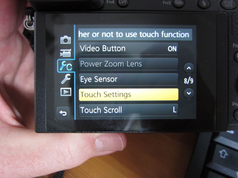

You find these options in the "Costum Setup" group under "Touch Settings"
I use the following settings, to be able to change the AF point with the touchscreen...
but apart of that the touch screens is disabled.
Only if I press the Q-menu button (labled Fn2/waste paper bin), I can select the options on the screen with my fingers. If you want to disable that too, simply set in the first line (see image above) "Touch Screen" to "off".

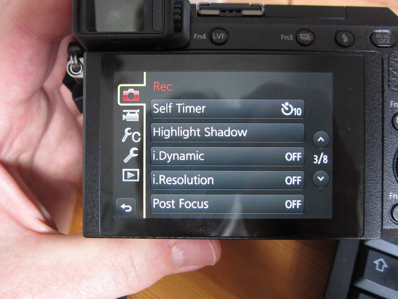

Many camera-brands offer nowadays in their different models options in the settings to improve the image qualilty of the photo. Same goes for the Panasonic GX80/GX85.
I am not a fan of these "improvements" (I am not talking about film simulations here). In most cases it does not improve anything, it makes image quality worse. If you know how to shoot then shoot in RAW and make adjustments later for yourself. So I disable the option "iDynamic" and "iResolution". It is for jpegs ooc anyway and if you shoot RAW, it is always better to do it yourself afterwards in postprocessing.
iResolution is a kind of selective sharpening, iDynamic is more complex. The processor is applying a lower contrast tone curve after sensor capture. The tone curve is applied to JPEG only. But there are discussions on the net that this could also effect the RAW images. I have not tried it yet.
Whoever wants to test iDynamic, go ahead and report here back.

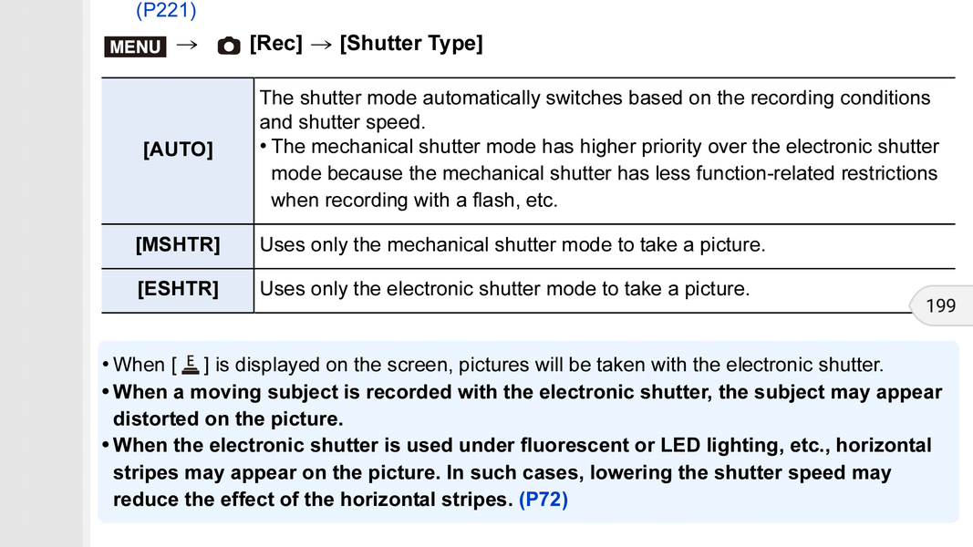

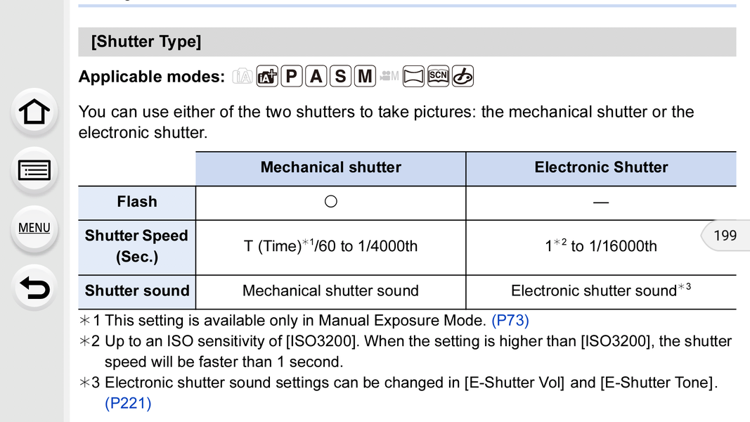

The Panasonic Lumix GX80/GX85 has 3 different settings for the shutter type available.
Here are the explanations in the official GX80 manual:

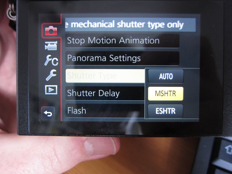

You want to avoid the rolling shutter effect. Although this is less of an issue with the GX80/GX85 compared i.e. to the Panasonic Lumix GM5 or older models.
Therefore I use mechanical shutter ("MSHTR") as often as possible (attention: check also sound options in the settings above posting #3 click here). Since the GX80 has a mechanical shutterspeed up to 1/4.000s, this should cause almost no limitations.
The electronic shutter of the GX80 ("ESHTR") goes up to 1/16.000, if needed.
I did not check yet the setting "Auto". Looking at the explanation in the manual, it sounds promising, but I prefer to keep control when the camera is using which shutter type. I do not know how I can control that in the Auto setting while shooting.
