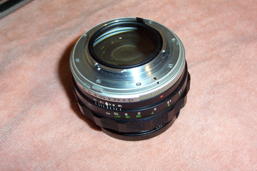

Here are the steps taken to convert a Minolta 58mm f1.2 lens to a SD14.
The lens at the start.

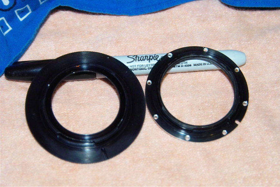

Then the flange removed, auto aperture linkage discarded and displayed with the M42 adapter.

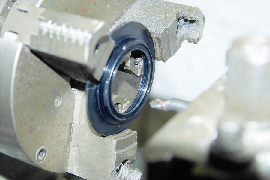

Boring bar setup to remove the lip

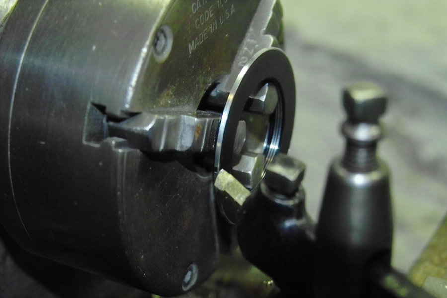

Then the thickness reduced from 1.5 to 1.0mm to match the original mount
The before and after of the M42 mount
