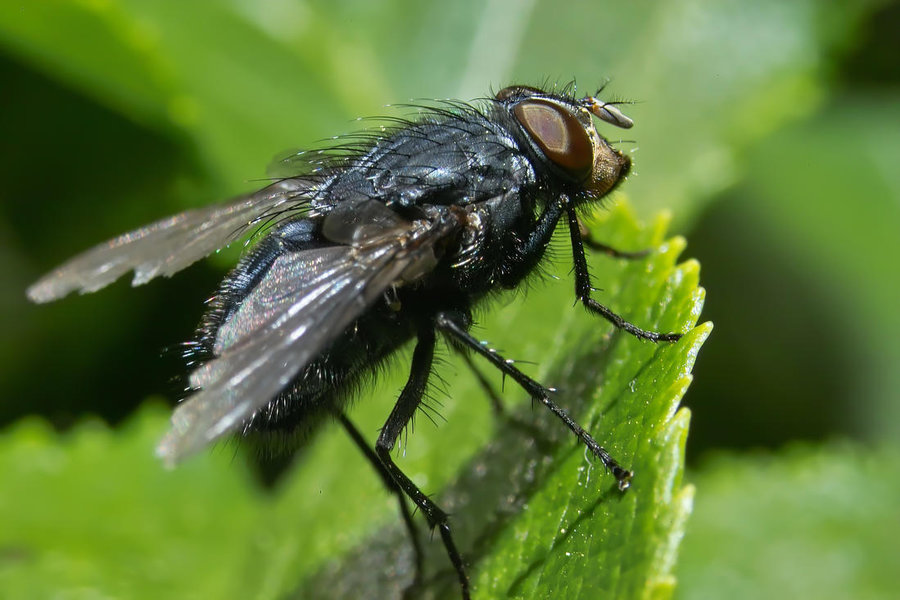

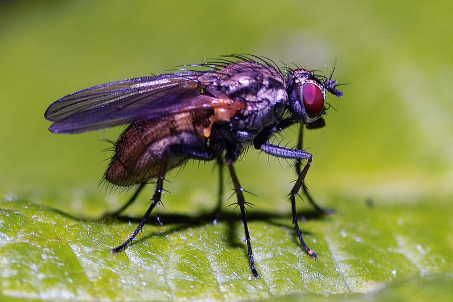

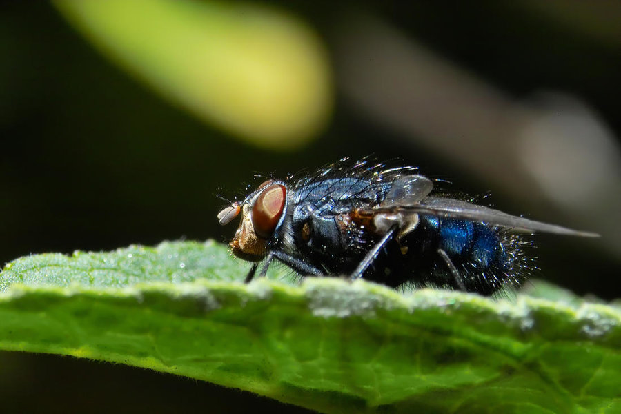

Hi Jasonh,
M42-Macro works perfectly as well. The only disadvanatage is that you have to slow down aperture manually. You will have to cope with a fairly dark viewfinder then! I do not mind that all that much.
View attachment 1526 View attachment 1527
All these shots are M42-results (PORST 75-260mm F:4,5 MACRO-ZOOM + M42 bellows.+ flashlight)
If I remember right, I had it slowed down to F:16 for wider DOF.
