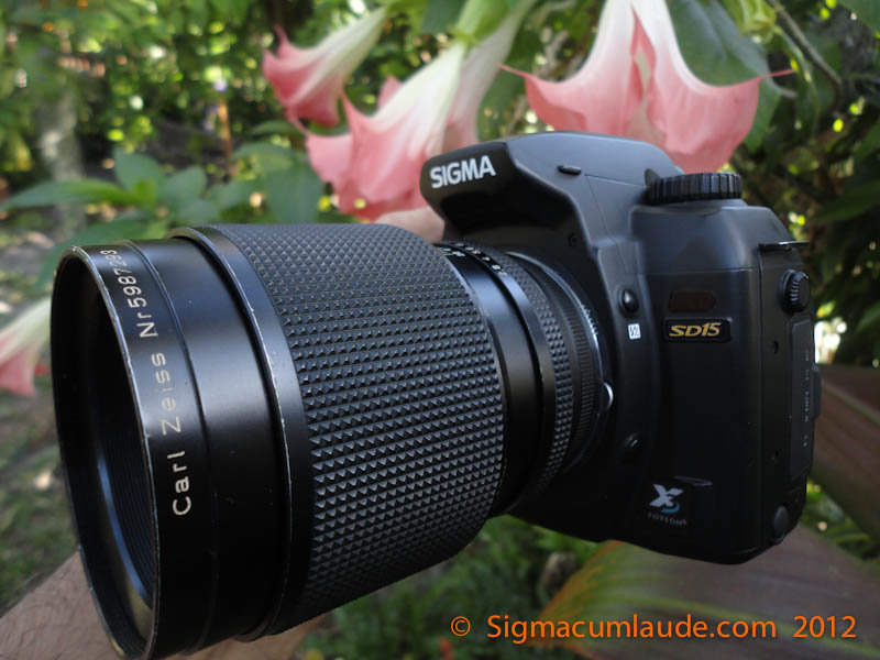

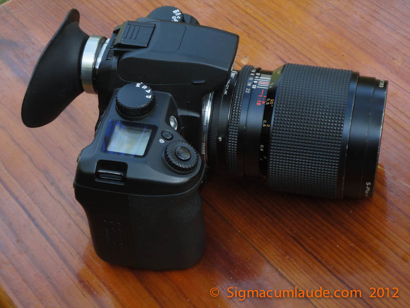

The SD1 increased resolving power needs better lenses . Sigma itself might produce them at some point but even then people have their own preferences in terms of Lens Character . There are Cultural differences of Vision that reside at the very base of people preferences that make them dress differently , use different colors and like different foods , among other differences . I prefer German Glass to pair with the Foveon sensor . Right now I am testing a Prototype Contax C/Y Mount Replacement on an SD15 camera witha Contax MM S-Planar Makro 60f2.8 lens .
The results are very impressive:
However we will not proceed to manufacture this mount until all this issues has been addressed properly. Modern Firmware should allow for the use of Lens Profiles right on the camera . Sigma's Merrill does not even work properly with a manual lens.
