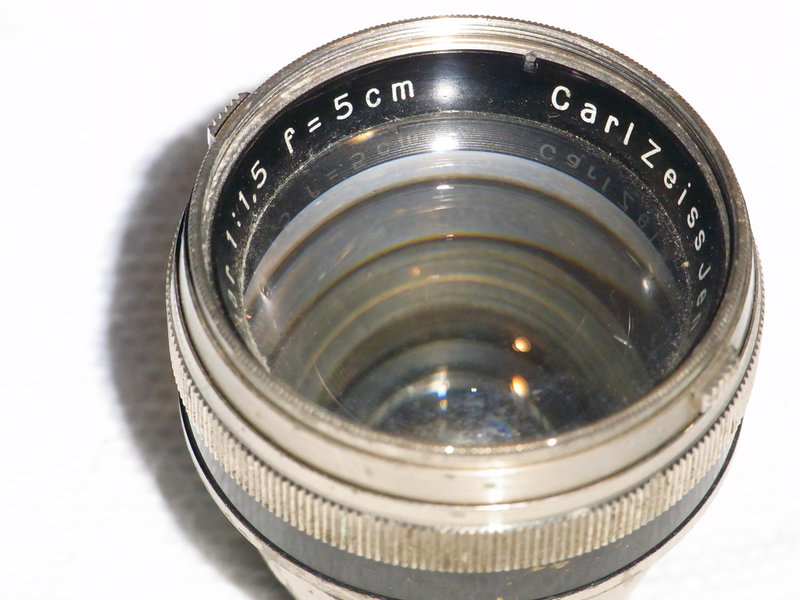

A chance to use the other side of the brain.
$67 off Ebay, Carl Zeiss Jena 5cm F1.5 that looked like wax paper.
Full CLA and conversion to Leica Mount using a Jupiter-3 focus mount made of left over parts.
RIMG0017.jpg RIMG0023.jpg RIMG0024.jpg RIMG0028.jpg sonnar_1607_1.jpg sonnar_1607_4.jpg L1003140.jpg
I've done about 70 Sonnar Contax to Leica conversions like this, they are fully reversible. If the glass from the J-3 is good, convert them to Contax mount. I have a lot of Jupiters with bad glass in the parts bin.
View attachment 2935 View attachment 2936 View attachment 2937 View attachment 2946 View attachment 2947 View attachment 2948 View attachment 2953
Nice conversion
