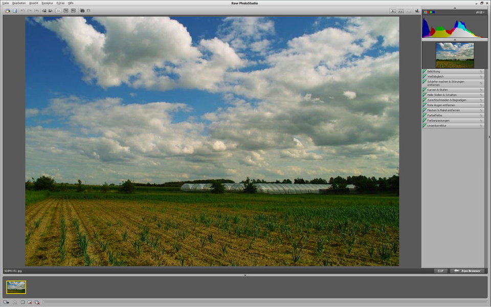

Hi Rich,
no problem ... I am going to show you, what I did!
First of all!!
There is only one, who is perfect to develop a photo and that is the photographer himself! He/she is the only person, who really knows colours and moods, as they really were at the moment of shooting the picture!
I now can only estimate, what might be realistic .....
But ... cameras are not always perfect. I know the SD14 as relatively reliable with white balance and colour accuracy. In this case, the WB seems to be wrong to me ... slightly green/yellow shifted?!
Did you use "AWB" or another WB-setting?
All cameras do such mistakes ... by the way mentioned!
Another important point .....
I do not know, which software you use with digital picture development?!
It really does not play a role! What I am going to illustrate now, can be done with any software available ... it is very basic image processing!

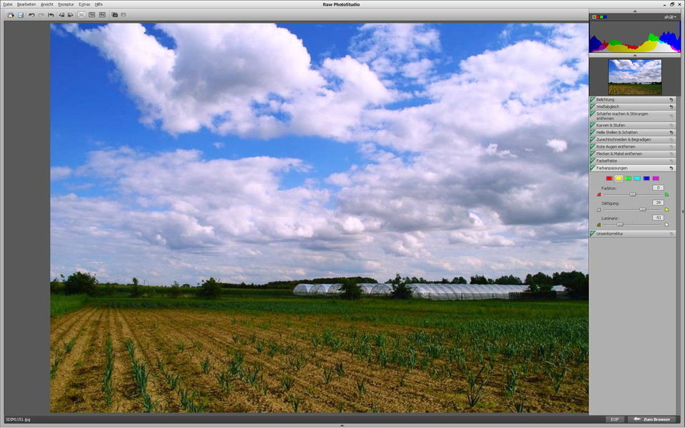

Here we are ... this is the way, it looks ... slightly "sinister" and yellow ....
The next step, I reduced "colour temperature" to around 4400 Kelvin .... in easier words ... I made the WB colder ... that is more blue ....

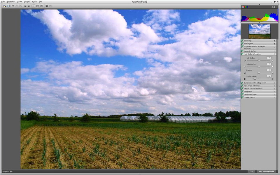

Next step ... I darkened the shades slightly ... this makes the pic more plastic and three-dimensional .....
Finally, I strengthened the "yellows" in colour intensity and darkened them a bit.
DONE!
So, I find this picture well balanced.
More imprtant is, that you feel comfortable with the result?!
Just do some experiments! ;)
