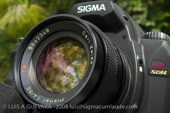

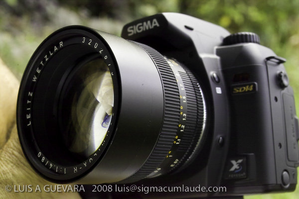

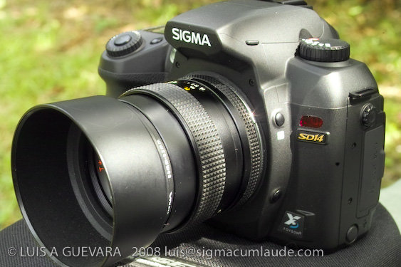

Thanks Dirk. There is no problem with focusing at close ups since the internal optical elements move away from the mount . Infinity focus is achieved in most lenses larger than 35mm of focal length .
Short focal lenses sometimes present internal interference with the SD14 Dust Filter that, because it doubles as an Infra Red filter ,cannot be removed .This interference happens in some very old AI Nikon lenses that happen to have a Light shield at the exit pupil . In most cases that shield can be trimmed off with a Dremmel easily.
