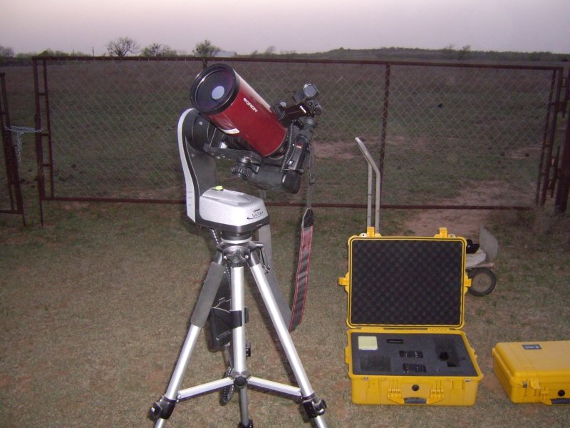

On the evening of April 4th, a friend and I went out to do some astronomy and photography. I had two goals for the evening, shooting of photo of the International Space Station as it flew close by Saiph, a star in the constellation Orion, and shooting a pair of Iridium flares an hour later occurring about one minute apart.
I have my telescope and SD14 all set up
But, when the ISS flew by, the sky was still too bright to even see Saiph. :sad:

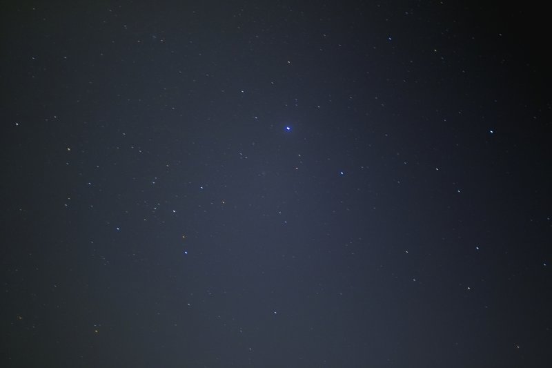

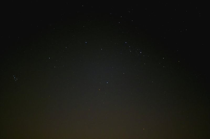

It wasn't a complete waste since I was able to shoot some nice constellation photos:
Canis Major:
Perseus:
and the Big Dipper (Ursa Major):
All the constellations were shot with a Sigma 28mm f1.8 DG EX Lens with a 30 Second shutter, f1.8, ISO 100, Sunlight White Balance, single images processed in SPP.

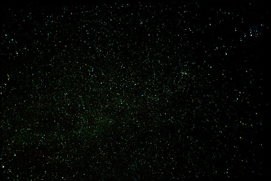

I used Deep Sky Stacker to align and stack the images. I left the default quality selection to stack 80% of the highest image quality frames, which turned out to be 19, equalling a total exposure time of about 5 minutes.
The Tiff file produced by Deep Sky Stacker had 96 bits per pixel and I used Photoshop to enhance and reduce the image to a presentable form:
:z04_smilieparty: Yay !!! The Sky is dark, free from noise. ALL the stars are points of light, not shadowed by illuminant triangular ghosts, the strange noise in the upper right of the image is gone.
The only compromise that I made to the image presented here was to not have the glow from the Milky Way being too prominent. Very subtle changes to my Photoshop adjustments control the expression of the Milky Way, indicating that this image actually contains a lot of quality data.

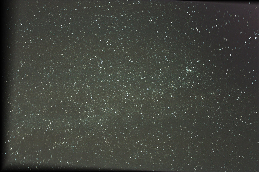

Look at the DeepSkyStacker results Here ( Just a few posts earlier to this thread )
and compare to what AIP4Win yielded:
A note of distinction between the DeepSkyStacker image posted previously and AIP4Win the image, both needed processing in Photoshop to allow them to be presented here. Since the Milky Way passes through Cassiopeia, I toned down the Milky Way's glow to better bring out the stars in the DeepSkyStacker image. I did not feel going to such efforts would have improved the AIP4Win image.

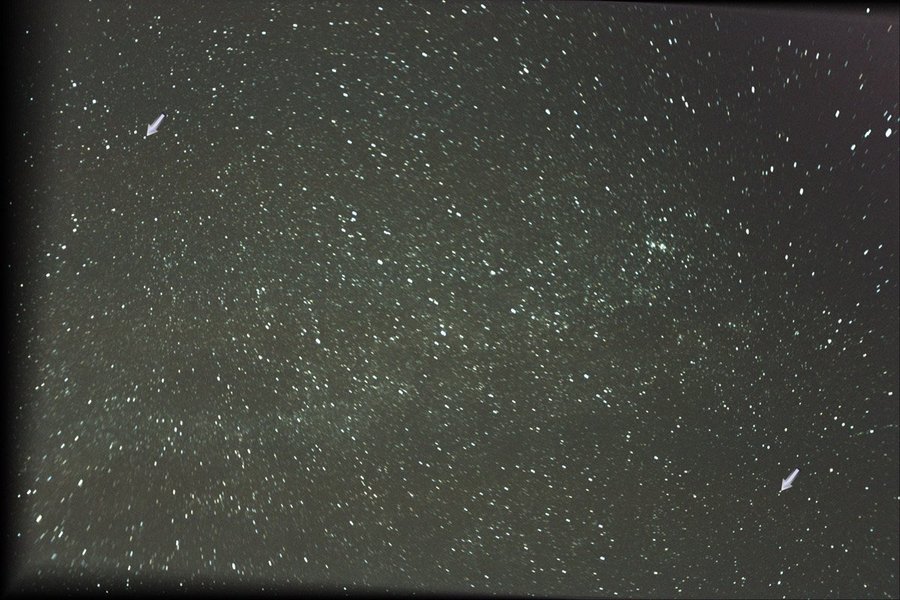

And here are the stars I had to manually identify for every frame to AIP4Win:
A lot of good that did :z04_head_wall:
You can see why I immediately concluded that I must have done something wrong. This is the first time that I used AIP4Win's stacking function. Only in the areas surrounding the alignment stars do the stacked stars achieve alignment. The further away from the alignment stars, the worse the distortion. Compounding this, look at the orientation of the distorted stars - the distortion varies and is inconsistent.

mmm, b-u-t DeepSkyStacker took the very same collection of images, accurately identified from 84 to 146 stars in each of the 24 images, 19 of which were used in the stacking after receiving a quality level of 877.67 to 1024.83 and accurately aligned each, completely over the full field of view all on it's own. And remember, these frames where manually shot, leaving the frame to frame time variable, with my SD14 sitting on a static Velbon tripod. ( I couldn't make it more challenging by tieing one hand of my SD14 behind it's back since it doesn't have hands. I could have waited for the Moon to rise, but it was just too cold :rolleyes: )
