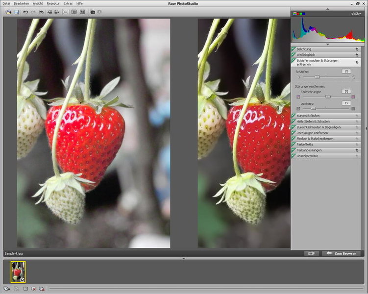

Hi All,
well, all this can easily be done with a software named Raw Photo Studio.
Unfortunately, my screenshots now are based on a German edition but I am going to explain, what I have done ...i.e. .. the single steps of image processing.
Finally, all this can be done in just one single little click .. let us see:
1) strengthening contrast... this does not burn out the lights but darkens the shadows...:)
2) working on details: Here you can adjust sharpening and denoising your image. Luminance and chroma noise filters can be adjusted seperately! The chroma filter very well works against the typical low frequence colour noise of the SD10/14 pictures. Detail detection also works best. There is no better denoising engine for SIGMA HIGH ISOs I can think of....:)
3) selective colour control: Here you can do everything to work on an "ISO 1600's" pale colours.
Finally ... and this is clou .... you can define all these settings as a filter and apply it on all your ISO 1600s with just a single click!
__________________________________________________________________________________________________________________
Raw Photo Studio can do both ... working as a converter (it processes X3Fs SD9/10/14 (no Polaroid X530 and no DP1 files)) or work with JPG- or TIFF-files.
In this case, I used SIGMA PHOTO PRO / SPP2.5 for conversion and did the further image processing with RAW PHOTO STUDIO.
I did NO CHANGES with SPP of course!!;)
