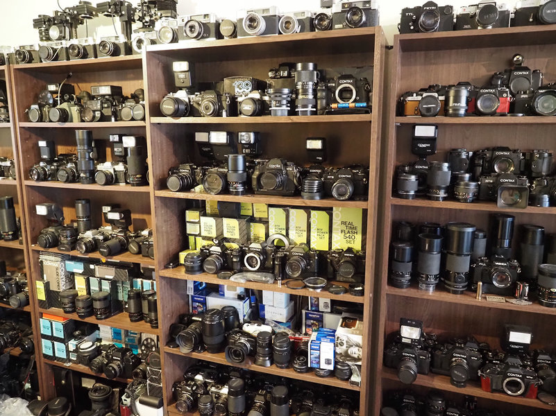

Always great to hear from another Contax fan... As you might guess from the attached piccie from my study, I have a minor penchant for Contax and Yashica kit and Zeiss glassware. They all get used at least once a year and the lenses get used constantly on both film and digital cameras. The only worry is, when carrying lenses like my Zeiss 500 f4.5 Mirotar (hernia inducing for a mirror lens) or a Contax RTS Fundus, what happens if you drop them - not easy to replace!

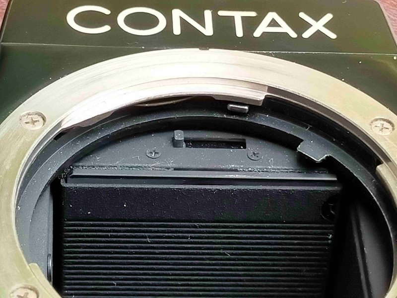

Saturday morning, so time to look at my two beloved ones ;) . The result was pretty worrying...
This seems to be the way it should look like:
And on my second camera (which I have been using for almost 30 years) it looks like this:
Glad that I found it - it seems to me that otherwise another catastrophe might have happened pretty soon. o_O
So it was time to come into action. I have practiced first on my damaged RTS II and then on my Yashica FX-D. I used a heat gun with its lowest temperature, 50°C.
After some minutes the mirror carrier had got pretty warm (but not hot). The mirror could be moved carefully into its correct position.
I will watch what happens during the following days/weeks.
Fingers crossed....
