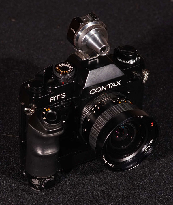

As for my RTS II bodies - for now I have decided to be careful, even when the mirror is adjusted. So my solution is: either taking my Yashica FX-D body.
Or... :cool:
This is a pre-war finder from Ernst Leitz Wetzlar :proud:, manufactured for Leica II / III (I guess), which I originally bought to use it on my 1936 Contax II.
It can be adjusted to work with a 35 mm wide angle lens. My method: first using the RTS II's finder with the Distagon 18 mm. Remembering what is in the middle of the focusing screen. Then moving up the mirror and switching to the Leica finder - searching what was in the middle of the RTS II finder and placing it in the middle of the Leica finder. Then taking the picture. Moving down the mirror again.
I know it's pretty complicated ;). But it's better than to ruin another RTS II body...
Michael
