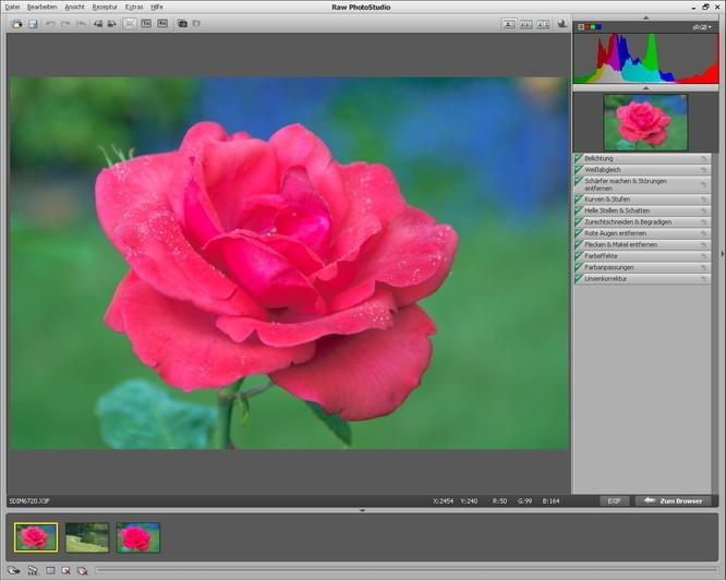

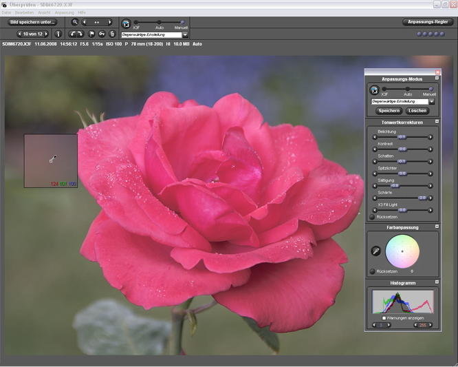

Well, I took this photo with my SD14 with NO exposure-corrections (multi spot metering). As expected, the red channel strongly overflows ... as the histogramme clearly indicates ....:eek: All SPP sliders are in "0"-position.
The rose does not look nice ... somehow washed out ... no fine details in the rose's petals ....
The only options to correct the histogramm are first to darken the image until the red cahannel performs correctly (let us forget this!) or to reduce colour-saturation to the necessary extent ... let us watch this option...
Well, now we have detailed structures in all petals but ... the rose looks pale and flat now ... no real solution, I think.

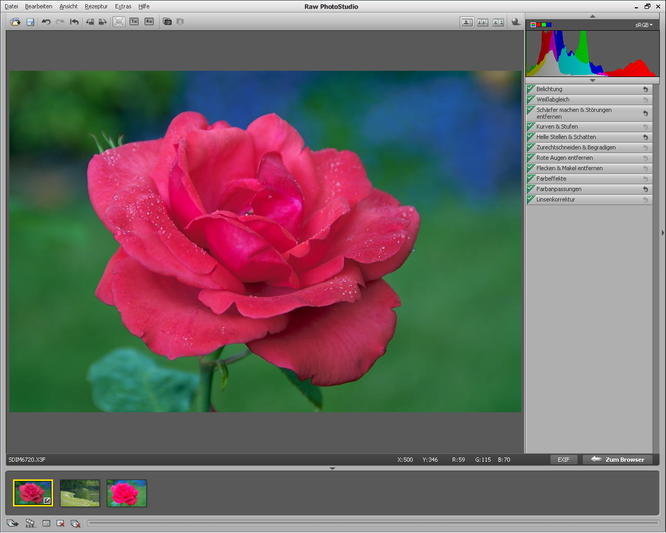

As I found out ... the X3F-RAW-file is not the problem! It contains the necessary image information ... In this case it is the SPP converter, which cannot handle this problem.
I took another converter ... namely RAW-PHOTO-STUDIO.
First the RAW with NO corrections ....
The problems now are exactly the same compared to SPP! The red channel overflows absolutely .... as the histogramme indicates, too.
But, RPS provides the option, to adjust different colours differently and independently. So, you can adjust the red colour range independently as far as colour saturation and brightness are concerned. This is, what I just did in the next step ... a very small correction of the image contrast ... and ..
Now watch the detailed structures of the petals, colour saturation and the histogramme.
Done, I would say.

In fact, there is a difference between Arcsoft Darcroom and RAW-Photo-Studio!
Both softwares are similar ... but not the same! Arcsoft Darkroom was first, before they sold there software to "IMAG MASTER". So, RAW PHOTO STUDIO is Darkroom's progression.
http://www.rytterfalk.com/2007/10/08/raw-photostudio-darkroom-159-high-iso-flash-movie/
Here, Carl Rytterfalk shows basic functions .... :)
The "Garish Red Problem" can only be solved with RAW-Photo-Studio ... as I showed above! Darkroom does not have the selective colour menue, which was added with the later RAW-Photo-Studio!
So ... get you RAW-Photo-Studio to replace Arcsoft Darkroom! :)
Follow the steps, I indicated above! Most probably, you will be successful!
